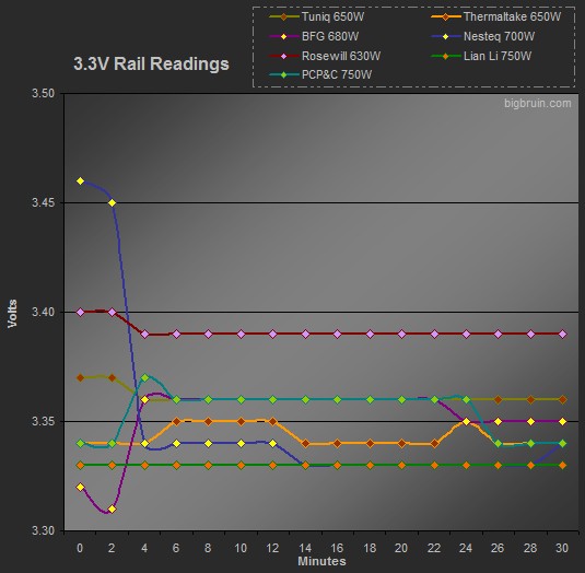

The third chart shows the regulation on the 3.3V rail, and unfortunately numerous units locked in at 3.36V and you can not see the line for the Tuniq unit except at the beginning and the end. The results were well within specification, and the regulation was very tight, so there isn't anything to complain about here.
Overall the Tuniq Potency 650W unit did not do poorly. The values it put up were not the best, but the results were all within +/- 5% of specification, and the regulation was respectable.
