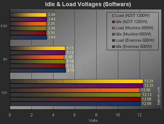

The first chart details the results obtained by the multimeter...
The second chart details the results obtained using the Intel Desktop Control Center software...
After first taking these numbers I was a little surprised, so I conducted the load testing again to confirm that there is almost no voltage fluctuation. This is some of the best voltage control I have ever seen.
