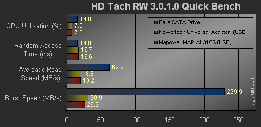

To test the speed of the drive I used the Quick Bench of HD Tach RW version 3.0.1.0. The graph below shows the drive's performance while connected directly to a SATA header, while connected via USB 2.0 in the Mapower enclosure, and while connected via USB 2.0 using a Newertech Universal Drive Adapter.
The lack of the necessary eSATA cables prevented testing via that interface, but the USB results show that the Mapower enclosure performs up to par.
