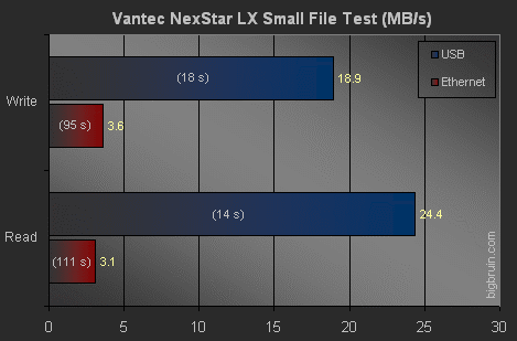

With the Vantec NexStar LX configured, it was time to put it to good use. I first tested the speeds via USB, and then switched over to a network connection where I intend to use the drive for both SMB and FTP access. In USB mode the drive was detected by Windows XP and quickly made available as any other USB drive would be. None of the SMB or FTP settings apply when used in this mode, but I wanted to test the speed anyway.
A folder consisting of 80 MP3 files and a total size of 341 MB was passed to and from the drive to test the read/write capabilities. These same files were then passed to and from the drive using an Ethernet connection using SMB and FTP. The NexStar LX was connected to a 10/100 Mbps router/gateway, which in turn was tested to the computer used for all file transfers.
The table below details the results of the transfer using USB and SMB, while FTP transfer results will be discussed below. The yellow values are the transfer rates in MB/s, while the parenthetical values in grey are the actual transfer times. (the test system was rebooted after each transfer).
As compared to other USB enclosures, the NexStar LX provides great transfer rates. If you do decide to only take advantage of the USB connection on this, you will be pleased with its performance. The Ethernet transfer may look poor in comparison, but they aren't bad.
