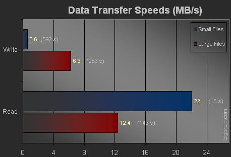

Real world data transfers were monitored in four phases... large file write, small file write, large file read, and small file write. "Large files" were compromised of a total of three ISO files with a combined file size of 1772 MB. "Small files" were comprised of a total of 371 image files (JPG, GIF, and PNG) with a combined file size of 353 MB. Testing involved transferring the groups of files to and from a RAID 0 SATA hard drive array to the Mega-Kart via a rear panel USB 2.0 connection. A stop watch was used to monitor all times, a reboot was performed between each test, and the table below details the results.
Real world results echo what was seen in the benchmarks quite accurately. Read speeds are very fast, while write speeds are painfully slow. As with the benchmark results, these tests were also repeated (to no avail) just because I could not believe the disparity in values. Consider this... It would take about 227 minutes (3.8 hours) to fill the 8GB Mega-Kart with image files like this, and that is definitely not "high speed". Perhaps this is why no speeds are listed in the product specifications.
