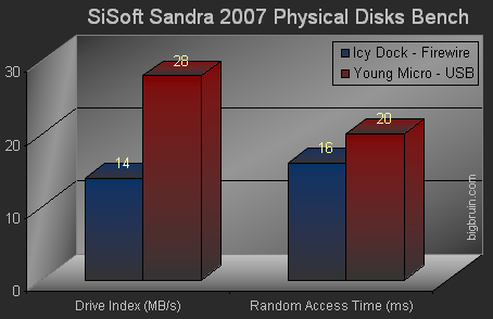

The first test run was the SiSoft Sandra 2007 Physical Disks benchmark. Two values were extracted from the results of this test; one being the Drive Index (in units of MB/s), and the other being the Random Access Time (in units of ms). Higher values are desirable for Drive Index, while lower values are available for Random Access Time.
As you can see from the results above, this test indicates that the MB124E isn't particularly fast! The Drive Index represents an analysis of drive speed, and the USB 2.0 enclosure was exactly twice as fast (and about as fast as I was expecting)! Realizing that Firewire should be able to beat USB 2.0, I ran the test several times, and could not improve it. I tried with or without the power adapter, and even tried on my only other system with Firewire, and the results were always the same.

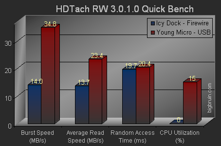

With a questionable set of results from the first benchmark, I moved on to running Simpli Software's HDTach RW 3.0.1.0 Quick Bench. This benchmark is similar to the Physical Disks benchmark from SiSoft, but we will look at a few more values. This time we want higher values for Burst Speed (in MB/s) and Avereage Read Speed (in MB/s), but lower values for Random Access Time (in ms) and CPU Utilization (in %).
From the results above you can see that this test confirms what the first one indicated... the MB124E is pretty slow! On the positive side, the random access time was a bit better, and the CPU utilization improved greatly when switching from USB 2.0 to Firewire!
I use other Firewire enclosures for a DVD burner and a 3.5" hard drive, and have never experienced poor performance. I am not sure what it is about the Icy Dock MB124E, but it could not get it to perform at anything better than half of what a cheap USB 2.0 enclosure could do!
