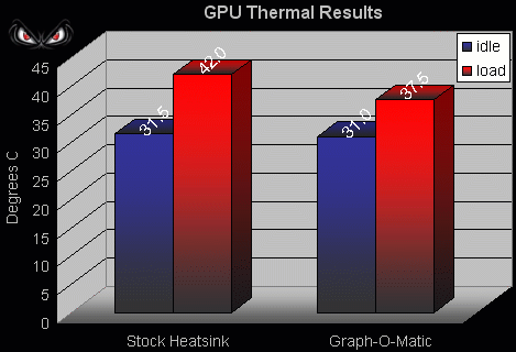

The gpu temperature was tested next, and the following software/hardware was used:
• FutureMark’s 3DMark 2001SE (to stress the gpu)
• Cool Bits overclocking utility (to stress the gpu)
• Folding@Home 4.0 (to stress the processor)
• Senfu Super Thermometer (to acquire temperatures from the gpu)
3DMark 2001SE is a standard benchmark for video cards, and is being used here to stress the video card and generate more heat.  Although 3DMark 2001SE is what I am officially listing as the stressing software, I did try a few other methods, including 3DMark2003 and playing a few different games, none of which provided any more heat. Folding@Home is not associated with the video card, but I left it running to simulate real world conditions where the cpu would be working just as hard as the gpu, and perhaps a bit more heat would be generated.
The video card in question does not have an onboard thermal sensor, so the SenFu Super Thermometer provided by High Speed PC was utilized. By sticking the sensor to the side of the gpu, overlapping onto the waterblock, reasonably accurate temperatures should be acquired, and the differential in temperatures will confirm any performance gains.  The image below shows the basic setup for obtaining the temperatures on the gpu...
For the idle portion of the testing occurred simultaneously with the cpu idle testing, and results were recorded.  For the full load testing, the card was overclocked via Cool Bits from 250 MHz to 275 MHz, and 3DMark 2001SE was set to loop indefinitely, with results monitored on the Senfu thermometer for one hour.  All phases of the testing were conducted while maintaining an ambient (room) temperature between 20-21 degrees Celsius and a system (case) temperature of 28-30 degrees Celsius.  The graph below compares the idle and load results of the Innovatek Graph-O-Matic waterblock with the stock aluminum heatsink which featured a small ADDA fan.
Once again, the idle temperatures show no real benefit from going to water cooling, but as soon as the stress on the card increased, the Innovatek XXS water cooling kit with Graph-O-Matic gpu block installed provided much better temperatures than the stock setup.  Just as noted on the cpu testing, the noise is also reduced, by eliminating one more fan from the system.
