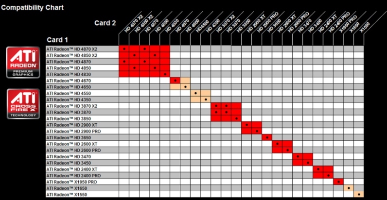

From what I understand, they don't have to be 100% identical cards, just from the same series; IE the 4800 series will do X-Fire just fine.

PostPosted: Tue, 28 Apr 2009 15:01:05    Post Subject: Reply with quote View Single Post
Yeah, ATI Crossfire is a bit different from SLI in that you have a few more options. Here is a chart with compatible video cards:
http://game.amd.com/us-en/content/images/crossfirex/CF_combo_chart.jpg
Dont forget to ensure your motherboard supports Crossfire.
