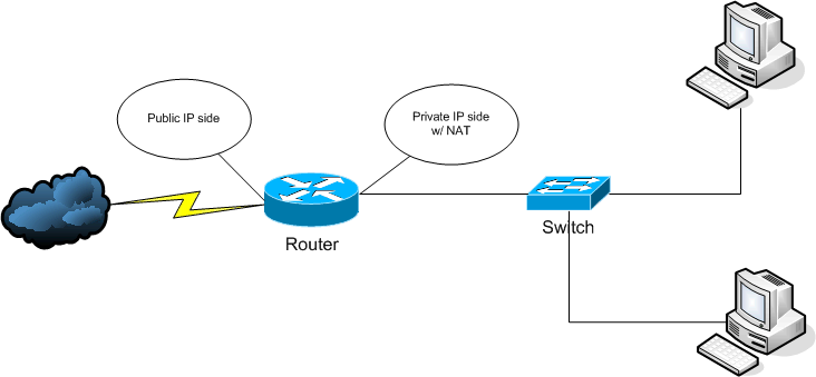

I'm still recovering, and very tired so I didn't look though this a whole bunch...
But basiclly your going to need to set up NAT on the router. It will aslo act as a DHCP server if you need it too. Then you need to hook it to a switch and your computers there. It's actually a very simple setup.

PostPosted: Sat, 17 Sep 2005 18:32:17    Post Subject: Reply with quote View Single Post
how will the topology of it look?

PostPosted: Sat, 17 Sep 2005 19:44:17    Post Subject: Reply with quote View Single Post
Basic 101 network design
 Filesize:  19.21 KB
 Viewed:  502 Time(s)

PostPosted: Sat, 17 Sep 2005 20:46:00    Post Subject: Reply with quote View Single Post
That didnt work when I first tried it...would that be because i didn't have NAT setup?
PostPosted: Sat, 17 Sep 2005 20:50:58    Post Subject: Reply with quote View Single Post
Most likely. You either need NAT, or a routeable subnet behind the router.

PostPosted: Sat, 17 Sep 2005 21:07:04    Post Subject: Reply with quote View Single Post
In router(config) should this set it up nicely:
Code:
#ip nat pool [name] 0.0.0.0 255.255.255.255
#access-list 4 permit any
#ip nat inside source list 4 pool [name]
#interface FastEthernet 0/0
#ip nat inside
#exit
#interface FastEthernet 0/1
#ip nat outside
#exit
Pretty much taken directly from my CCNA4 curriculum, with a few settings thrown in for loose security.
PostPosted: Mon, 19 Sep 2005 16:37:39    Post Subject: Reply with quote View Single Post
Since your in a CCNA class.... I'm not gonna give you the answers, instead I will point you in the right direction so you can learn it. Grin
Start here: http://www.cisco.com/warp/public/556/12.html
Good reading: http://www.cisco.com/warp/public/556/nat-cisco.shtml

PostPosted: Mon, 19 Sep 2005 17:35:02    Post Subject: Reply with quote View Single Post
Why is it showing all the incoming connection to the router as a serial interface :-(
Good site, thanks for the reference. I think the code above should work, i had the IPs open so that it *should* work for any span of IPs. Still can't figure out how I would define exact IP address in the course of the plan. Im guessing I'd have to figure out my school IP address, along with the bitmask?
PostPosted: Mon, 19 Sep 2005 17:55:46    Post Subject: Reply with quote View Single Post
*hint* Try setting the "WAN" ethernet port to DHCP
And don't worry too much about it being Serial or Ethernet.
