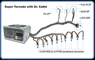

Turning to the “Dr.Cable” cable management kit. We find 2 split looms, 1 large for the ATX power connector and 1 small for the power leads. 1 cable mount to secure the cables to the case interior and 15 small nylon wire ties. By following the directions in the manual the Dr.Cable cable management kit will help keep the inside of your case uncluttered and allow a free flow of air for proper cooling of your system.

• Ample Molex connectors & lead lengths
• Dr.Cable cable management kit
