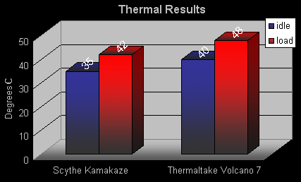

At idle the Volcano provided temperatures of 40 degrees Celsius at 3125 RPM, however the Kamakaze provided temperatures of 35 degrees Celsius at only 2343 RPM. Obviously this is a huge drop in both temperatures and speed, which equals gains in performance and quietness.
  Volcano 7 Load Kamakaze Load
At load the story is pretty much the same, with the Kamakaze coming in 6 degrees lower than the Volcano. The speeds are quite similar with the Kamakaze actually being a bit higher (the Volcano 7 has a thermally controlled, variable speed fan), but where it loses in speed it gains in temperatures.
The chart below shows the idle and load thermal results as discussed above...
