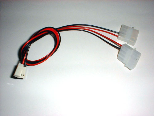

 The Noise Isolator rheobus arrived from Jab-Tech in the box pictured in the above left image.  The contents of the box are pictured in the above middle image, and include the following (listed clockwise from the upper left-hand corner):  1) two 3-pin extension wires, 2) concise users guide, 3) a pack of four mounting screws, 4) the rheobus, and 5) a 4-pin Y adaptor for receiving power.  The above right image shows an item not included with the rheobus, but a cheap adder that I would highly recommend.  Pictured are two 4-pin to 3-pin extension wires that will make adding 4-pin fans to your rheobus a snap, and will only set you back an extra $1.49 each.
