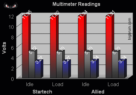

The testing of the power supply will consist of observing how much the main voltage rails fluctuate from idle conditions to full load conditions. A Radio Shack multi-meter (Cat. No. 22-810) was used to record all voltage readings, including measurements from the 5V, 3.3V, and 12V rails. Physically, the multi-meter was connected directly to the back of the 20-pin ATX motherboard connector, with the black lead placed on a black wired socket.  I placed the red lead on a red wired socket for the 5v rail reading, a yellow wired socket for the 12V line reading, and an orange wired socket for the 3.3V line reading.

The table below summarizes the results obtained after the testing was completed...
Analyzing the data in the table above, or taking a look at it depicted in the chart below, one can see that the two power supplies provide similar results.  The results are all well within the generally accepted specification of +/- 10%, but I would say a slight edge goes to the Allied unit due to the near zero fluctuations on any voltage rail.  The Startech.com unit proved to be stable, but the +12V line dropped 0.13 volts during testing, and the +5V line dropped 0.02 volts, whereas the Allied unit hardly flinched. The +3.3V rail reading of 3.27 is well within specification, but it is the lowest I have seen on any of the handful of power supplies to come across the test bench here.
