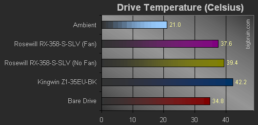

The final test was to monitor the drive's skin temperature using a thermal probe affixed to the center of the top surface while sealed inside the enclosure. With the drive active from a full test from HD Tach, the digital display from the thermal probe was monitored for the maximum sustained temperature. Here we see that the drive does get warmer than while in other configurations, but the temperature is not excessive. A cooler drive is a healthier and happier drive, so lower temperatures are always welcome.
