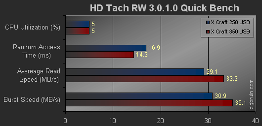

To test the speed of each drive I ran a HDTach RW Quick Bench with both Cooler Master X Craft enclosures connected via USB 2.0. As you can see the X Craft 350 was slightly faster at accessing and raw speed probably because the Seagate drive in the X Craft 350 is 7200RPM opposed to the 5400RPM Seagate in the X Craft 250.

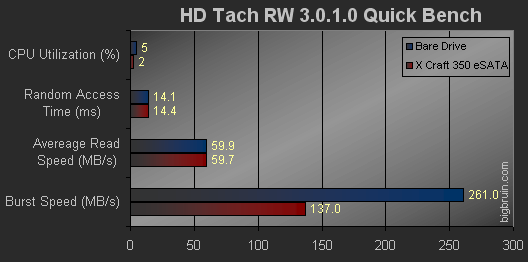

For testing the eSATA interface on the X Craft 350 I hooked up the eSATA cable to the front of my Enermax Charka case. This eSATA port is connected to a SATA 3 Gbps header on my motherboard so we should see some fast burst speeds. I was shocked to see a burst speed of 137 MB/s with the X Craft 350. I removed the hard drive and connected it directly to my motherboard and got a much more acceptable result; 261 MB/s burst speed. Apparently the enclosure physically supports SATA 3 Gbps drives but not at full speed.
