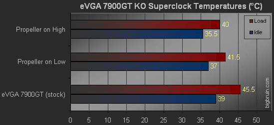

The way the Propeller looks is one thing, however how it cools is obviously more important. I will monitor my video card's temperature on both the low and high fan speeds. In order to push my card, I will run 3DMark06 and Everquest 2 for several hours while monitoring the temperatures.
As you can see in the chart above, the Propeller cooled my eVGA 7900GT KO Superclock card 4 degrees Celsius better than the stock cooler alone while on low speed. On high speed, the temperature dropped another 1.5 degree Celsius for a total drop of 5.5 degrees Celsius over the stock cooler. The noise produced by the high speed setting might not be justifiable considering the minimal drop in cooling, but the silent operation and 4C drop at low speed was definitely welcome!
