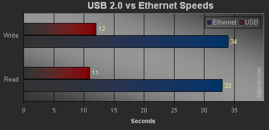

Now let's take a look at some real world transfer rates. These tests were performed watching the Windows XP clock, and each file was transferred five times to various directories and the average of those transfer times is listed below. The test file was a 350MB video file. As you can see, the read and write speed was identical when using the Ethernet connection. Using the USB2.0 connection, the same file was transferred in almost 1/3 of the time as over the Ethernet connection.

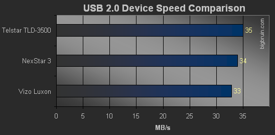

Finally, using HD Tach I compared the only common connection between the TelStar TLD-3500, Vantec NexStar 3, and Vizo Luxon... the USB 2.0 connection. As you can see all three devices transferred data close to the same speed. However, the TelStar TLD-3500 surprised me by outperforming the NexStar 3 by 1 MB/s. This may seem like a small amount, but if you transfer a large amount of data you might save yourself a little bit of time.
