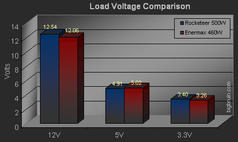

All voltage testing was done with the Rocketeer connected to the afore mentioned A64 system with the power supply sitting on the desk. We used the Enermax 460 for a comparison, and all voltage readings were taken with a Fluke 77 digital multimeter. Loading of the system was accomplished by keeping the CPU under 100% load running Folding@Home, burning a CDRW using Nero, playing a CD in Winamp, all while defragging the hard drives.
As you can see both power supplies stayed within 5% of specifications, however the Rocketeer SP-500W was very close to the upper limit on both the 12 volt and 3.3 volt rails.
