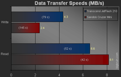

The next phase of testing involved reading and writing a folder of MP3 files to and from the JetFlash 210. A folder consisting of 80 MP3 files and a total size of 341 MB was passed to and from the drive to test the read/write capabilities. All transfer times were recorded, and the test system was rebooted after every transfer. As a point of reference, the SanDisk Cruzer Mini featured earlier in the review was also used for the same transfers. The chart below details the results.
The published specifications (Read 9 MByte/s, Write 8 MByte/s(Max.)) for the JetFlash 210 are not the best on the market, and the actual results showed that they are optimistic values anyway. 6.6 MB/s versus 8 MB/s on the writing side of things isn't bad, but only providing 4.3 MB/s versus 9 MB/s on the reading side of things was a bit disappointing.
