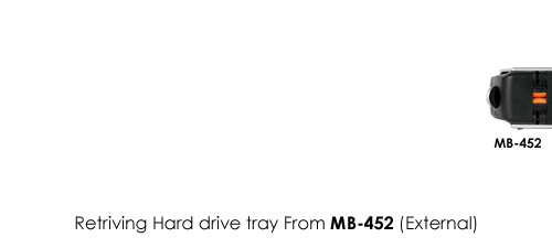

The previously reviewed Icy Dock External USB enclosure (MB452UK) is an IDE drive but could not be swapped into the MB722 even though the tray's connections were the same. The drive could not be read at all. The SATA version of the MB452 (MB452MK) can be swapped with the MB122 which is a cool thing if you need to take your hard drive to any other computer with a USB connection. It would be very cool for all of these enclosures to use a common interface so IDE can be hot-swapped with a SATA enclosure. Here is an animation of how to swap a drive from the MB452 to a MB122.
